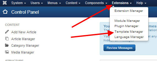

Step 2: Go to your "Extensions" and select "Template Manager"

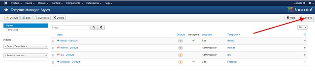

Step 3: The page should look like the picture below and then Click "Option"

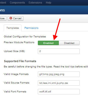

Step 4: In the Preview Module Positions. Click "Enabled"
Step 5: Click the "Save button

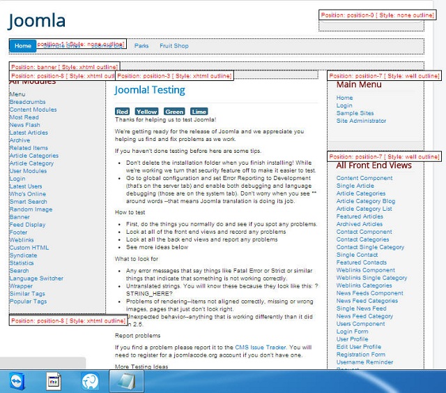

Step 6: Go to your frontend site and add the following suffix to your URL: tp=1
           Now the module positions and their names are displayed over the template in frontend. See the picture below
